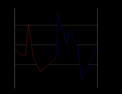

I have to draw grey lines in a profile and trim them as shown in the first attached jpeg.
The different coloured lines are polylines. Basically EXTRIM does half a job because it won't let you select multiple polylines.
Using modified code posted in the thread "Polyline Vertices" I've had a go at making something for a single horizontal line.
Basically this code finds all the intersections along a single selected horizontal line then draws new lines every 2 intersections, then deletes old line.
    ;; NOTE: to work you must select all PLINES in order from left to right...

When the code is correct I was going to have the program create the horizontal lines and apply this code to each one.
Problems at the moment:
  • I have to select the polylines in order. This is a problem because eventually I want to automatically select these plines filtering layer "Ground Line".
  • If the initial line in the first polyline goes from top-let to bottom-right the lines drawn will be the opposite of what I want (see second image (Profile2)).
Is this the best solution to this problem do you think?
Thanks guys for any help.

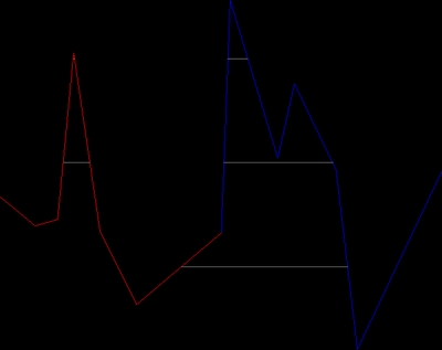

Try this mate ~ a different approach :)

Polylines don't have to be selected in order :P
As expected it works great. Thanks mate ;)

Yay :) I'm glad it works for you.
Lee
Ok so it was fairly easy to use the code and apply it to selection sets. Here it is if anyone else is interested:

The one thing I've noticed is it changes the horizontal lines to whatever is the current layer and color. I've yet to get around to deciphering visualLisp so can you show me the quick fix? I'm wanting the lines to remain in the colour they are, which is "Profile" layer, color 8.
Thanks

Because I'm making the horizontal lines right before running this I won't need to check if they're horizontal.
Btw. This code gave me an error but it was just cause I changed the selection set name from ss to ss_GL.
All good now though, that's another big problem solved, big thanks Lee!

One thing I didn't pick up on: whenever the first or last sections of the first and last polylines don't intersect the horizontal line a line won't be drawn (see first two attached jpegs to see what I mean - first image is what it does, second is what I'd like it to do).
I tried making lines either side of the profile but then I get other problems (see third jpeg).
Can you help?
I should add: I noticed that this program does work when the added vertical line at the start of the profile ends on the point where the polyline begins (as is logical I guess), so I probably don't need this to be solved if it's too much effort.

Yes, well, this is a bit of a tough one to account for, as the program does not really "know" which side of the polyline it is dealing with anyway.
