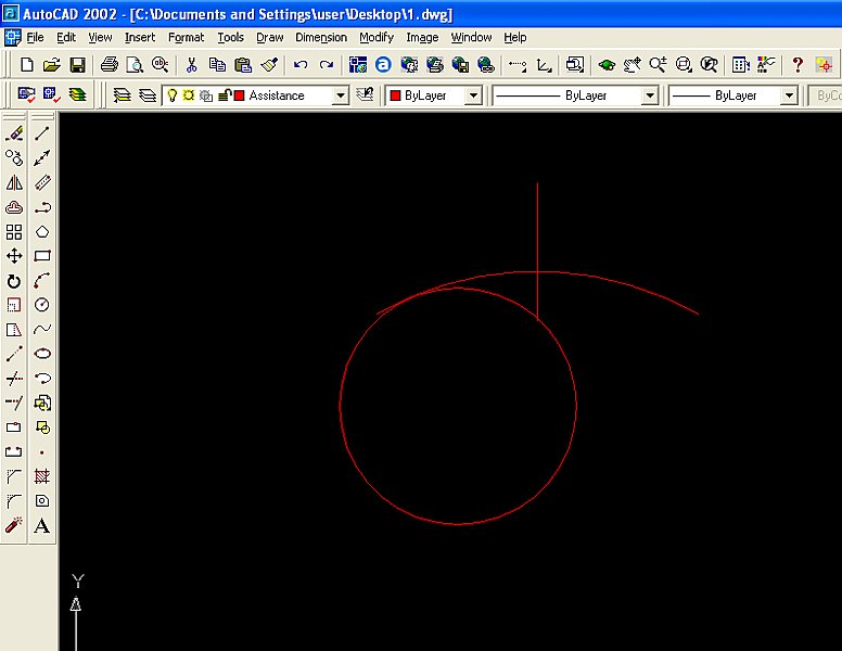

I need to move the circle shown here:
so that it becomes tangent to an arc and the endpoint of a line:
given these measurements
How do I do it? Thanks!

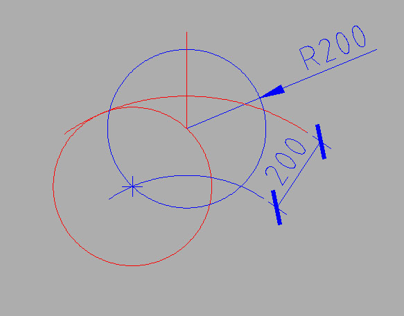

Offset the arc by 200. Draw a circle of radius 200 at the end of the line.
Where they intersect is the centre of the 200 radius circle.
Has that question been read correctly?
that circle isn't in a position where the line is tangent to it, although the arc is
surely the circle needs to be on the other side of the arc, such that it's the other end of the line that becomes tangent?

You cannot have a tangent to an endpoint of a line, therefore I read it as passing through the endpoint of the line as dimensioned, and the OP seems quite happy :D
You're right, I should have said 'passing through the end point of a line' instead of 'tangent to the end point'. Sorry guys. :D What's an op?
