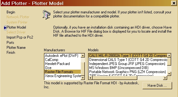

Look into SAVEIMG command. For a more detailed setup, you should be able to configure raster plotters. -David
When render, choose the destination to file instead of the render window. You will have more options to choose the file format and the resolution.
For sure the image will be better quality as using the screencopy method.
Oh, and if you set FACETRES to higher value, the rendered image will look smoother.
