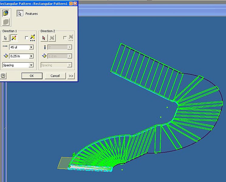

stevsmith Posted July 7, 2009 Posted July 7, 2009 The company that i work for designs feature staircases using 2d AutoCAD. Broken down into fabrication drawings for manufacturing. I have been asked by my compnay to investigate the advantages of moving over to Autodesk inventor. My concern is that it wont achieve what we require. My understanding is that it is more primeraly used for mechnical products rather that feature architectural works. Can you supply and images of feature stairs using inventor? And let me know if it would be benificial to switch over. Quote

stevsmith Posted July 7, 2009 Author Posted July 7, 2009 Do you think it would take alot to customise inventor to suit the nature of the project. I have uploaded an example of a stair I am working on just now. Its a twin stringer helical that cranks in 3 directions. 425-01 01 Rev F 1.pdf Quote
JD Mather Posted July 7, 2009 Posted July 7, 2009 Do you think it would take alot to customise inventor to suit the nature of the project. I don't know why any customization would be needed? If you do a lot of similar stuff of course you could set up iPart, iFeatures, iAssemblies and/or spread sheet driven parameters to make designs go very fast. Quote
shift1313 Posted July 7, 2009 Posted July 7, 2009 I think you would be very happy with the transition if you are designing these in 2d right now. You may produce some techincal issues that may have been missed doing this type of work in 2d. I just drew some lines real quick. I took your pdf, put a bmp in a 2d sketch and "traced" the path lines. I then did a few work planes and projected my 2d lines onto these planes. I drew one stair and tried real quick to do a linear pattern. I would have to play with it a bit to figure out if you could do it all in one path, but you can it to follow the path. same thing with hand rails, support beams etc. You can take all this and make a 2d drawing from it after as well. Quote

stevsmith Posted October 13, 2009 Author Posted October 13, 2009 Curious, I am assuming you want to transition to 3D. Have you tried drawing any of your plan-view stairway's in 3D yet using AutoCad? It is certainly very capable... I am a big Inventor and AutoCad 3d Fan and I think Inventor could certainly do what your asking, however, since you have 3D capabilities already at your fingertips, you may want to experiment with that a little before making a big purchase decision. Just a thought KC kc. I can actually do staircases in autocad 3d. but if there is a design change it can make life a living nightmare. Quote

Denimoth Posted October 13, 2009 Posted October 13, 2009 I'm also working for a company that designs ornamental metal products, which mostly involves stainless steel/glass railings on a stair (or many stairs). This one project I'm on currently also has us designing and fabricating the stair structure itself along with the railings. Stevsmith is correct in that when you receive design changes, or have to modify the stairs due to site dimensions (what an architect shows and how things are built on site don't always match), modifying solids in AutoCAD is a pain. I've been using AutoCAD for the past 11 years and am now really starting to think about switching to Inventor. I'm not at all concerned with using Inventor for the fabrication part of our drawings. I'm more concerned about whether or not we can also provide architectural style submittal drawings so that the architect and general contractor can review what we intend to make, and how it fits in with the other structures that aren't by us (i.e. floor structure, walls, ceilings, raised platforms, etc.). From my very limited knowledge of Inventor (I've only done a couple of tutorials using Inventor 2010 trial version), I figured out how to move different views onto new drawing sheets. But how can I change the View Labels to show a standard detail bubble (a circle with the detail number in top half, and the page number that the detail is on shown in the bottom half). I can't have a detail named "C" and have the architect flip through 30-40 pages looking for this detail. Can this be automated or do I have to insert it as a block (if that's even possible)? Also, I guess I'd have to create parts for the floor structure, walls, gypsum boards, steel studs, and will have to make sure these aren't incorporated into any BoM's or such, since they wouldn't be things our company would make or install on site. But these need to be visible on our submittal drawings so that our installers will know where to place the stair or panels or whatever, in relation to slab openings and wall locations that would be existing on site. Quote
