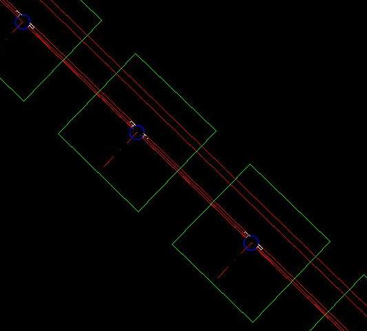

StevenMc Posted July 17, 2009 Share Posted July 17, 2009 i've been doing a drawing today where most of the lines are at angles. ifor some reason they look "jaggy". this never used to happen until today does anyone know the problem? its not my monitor or graphics because i've always had the same. also tried VIEWRES but the lines are still jaggy cheers -Steven Quote Link to comment Share on other sites More sharing options...

StevenMc Posted July 17, 2009 Author Share Posted July 17, 2009 316. funny angle lol Quote Link to comment Share on other sites More sharing options...
ReMark Posted July 17, 2009 Share Posted July 17, 2009 It's a anomoly. Ignore it. There is nothing wrong with AutoCAD, your monitor or your graphics card. Quote Link to comment Share on other sites More sharing options...
StevenMc Posted July 17, 2009 Author Share Posted July 17, 2009 It's a anomoly. Ignore it. There is nothing wrong with AutoCAD, your monitor or your graphics card. ok cheers ReMark :wink: Quote Link to comment Share on other sites More sharing options...

StevenMc Posted July 17, 2009 Author Share Posted July 17, 2009 anymore suggestions as to what it might be? im stuck i thought it couldve been an anomoly but its a strange one. Quote Link to comment Share on other sites More sharing options...
ReMark Posted July 17, 2009 Share Posted July 17, 2009 I can duplicate the same conditions on my system at will. Quote Link to comment Share on other sites More sharing options...

ReMark Posted July 17, 2009 Share Posted July 17, 2009 Try drawing a line at 315 deg. What does that look like compared to the one drawn at 316 deg? Jaggy too? Quote Link to comment Share on other sites More sharing options...
ReMark Posted July 17, 2009 Share Posted July 17, 2009 I submit for your approval the following: http://discussion.autodesk.com/forums/thread.jspa?threadID=410063 Quote Link to comment Share on other sites More sharing options...
StevenMc Posted July 17, 2009 Author Share Posted July 17, 2009 Try drawing a line at 315 deg. What does that look like compared to the one drawn at 316 deg? Jaggy too? i drew the line at 315 and it is smooth. i also redrew the 316 line and it is still jaggy. for some reason my Autocad dislikes the angle 316 . although it prints smooth i was still curious as to why it did that. its best i leave it at that angle as it only looks jaggy. Quote Link to comment Share on other sites More sharing options...
StevenMc Posted July 17, 2009 Author Share Posted July 17, 2009 I submit for your approval the following: http://discussion.autodesk.com/forums/thread.jspa?threadID=410063 thanks ReMark great help :wink: Quote Link to comment Share on other sites More sharing options...
ReMark Posted July 17, 2009 Share Posted July 17, 2009 You're entirely welcomed Steve. From time to time I'll get a jaggy line and try to straighten it out only to kick myself for having wasted valuable time. Quote Link to comment Share on other sites More sharing options...
