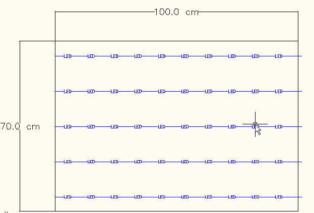

Proctor Posted July 21, 2009 Posted July 21, 2009 Hello: I have a drawing that has been done in millimeters. at least...well, that's my question - was it actually done in millimeters? under format ->units, millimeters is entered; also, when i enter measurement i get 1, which is for metric; however, if you look at the dimension, you will see that they have chosen to display cm and I'm assuming that this is incorrect - but would like to verify this. thanks, Proctor Quote

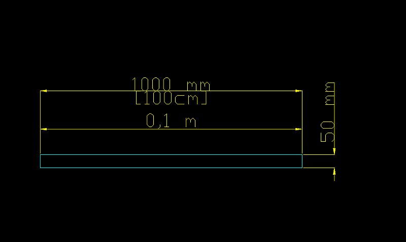

NaeKid Posted July 22, 2009 Posted July 22, 2009 Is it possible that the file was drawn in milimeters and the dimension controls changed to display in centimeters instead? You can change (and play with) the dimension scale / controls etc by hitting d Here is a mini-sketch showing what I mean .... Quote

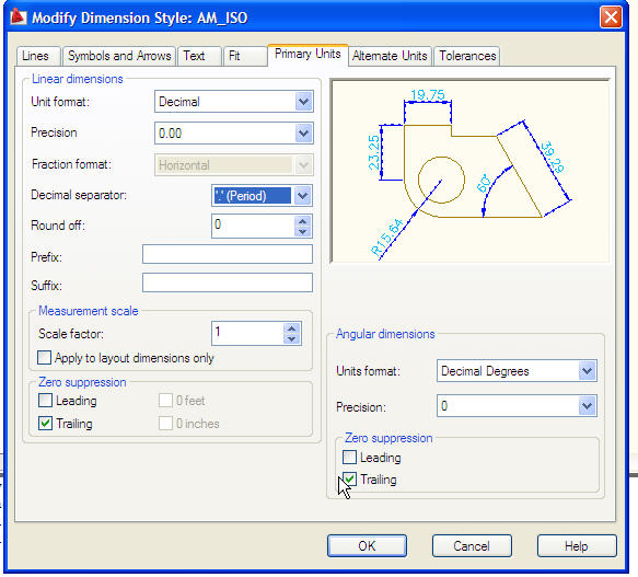

Proctor Posted July 22, 2009 Author Posted July 22, 2009 hi naekid - thanks for your reply. I see what you're saying. when i enter "d" command, i see where you have the capability to have it display a certain way; however, when i look there, i see nothing entered that would determine if they drew in millimeters but set the dimension to display in centimeters (see pic). i think i will therefore, ask the user that sent me this drawing so that i can ge to the bottom of what's really happening. thanks again for your help. procto Quote
Proctor Posted July 22, 2009 Author Posted July 22, 2009 when i draw a line 100 units in this same drawing, it gives me the same length as the orginal drawing. wouldn't this indicate that it's really 100 millimeters? Quote
NaeKid Posted July 22, 2009 Posted July 22, 2009 It is 100cm = 1m ??? I believe 100cm = 0.1m (as shown) and 1000cm = 1m Quote

totzky Posted July 23, 2009 Posted July 23, 2009 when i draw a line 100 units in this same drawing, it gives me the same length as the original drawing. wouldn't this indicate that it's really 100 millimeters? If by the "red-colored text" you mean You dimensioned it, yes your in millimeters. If you want us to verify, attach your .dwg file and we'll take a look. Quote
