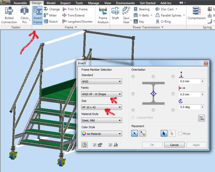

MarkFlayler Posted April 20, 2011 Posted April 20, 2011 What's wrong with using Frame Generator with a Skeletal Part? That works fine for me. Otherwise you can use iCopy with an Adaptive Assembly with spar components. Quote
caddman6425 Posted April 20, 2011 Posted April 20, 2011 I don't use inventor, I use ACA 2012. So what is this frame generator, something in Inventor only? Quote
JD Mather Posted April 20, 2011 Posted April 20, 2011 I don't use inventor, I use ACA 2012. So what is this frame generator, something in Inventor only? Frame generator is standard in Inventor (I didn't look at original information since it wasn't posted here). It works essentially the same as in SolidWorks, exept that in Inventor you place the skeleton in an assembly and place the frame members in assembly while in SWx you do in a single part file and then push out the individual parts. Quote

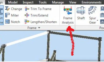

abccad Posted May 17, 2011 Posted May 17, 2011 Is it possible to analyze a 2D Truss structure using the "Frame analysis" module? I have added constraints to all nodes ( to allow Z rotation. ) But besides axial stress, I am also getting bending stress on the members. Do I need to use the "Release option" on the Truss members? It is unclear to me with the Inventor online help. Quote
JD Mather Posted May 17, 2011 Posted May 17, 2011 Have you gone through this book? http://www.amazon.com/Wasim-Younis-step-step-engineering/dp/B004VG3STE/ref=sr_1_5?ie=UTF8&s=books&qid=1305629345&sr=1-5 Quote
abccad Posted May 17, 2011 Posted May 17, 2011 I have ordered the book; but from the TOC, I didn't see the Truss analysis. The analysis results are showing additional bending stress, which shouldn't exist in Trusses. Anybody has done "Truss analysis" in Inventor? Quote
