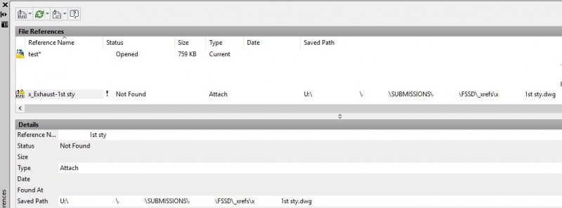

Batch change xref names and repath dwgs
JeepMaster
Try this:
Start --> Programs --> Autodesk --> AutoCAD 20xx --> Reference Manager
I designed an application to cater for these needs and then discovered this Autodesk freebie so abandoned my plans.
Hope this helps.
Wannabe,
Reference manager only repath the same xrefs, it doesn't work if the xrefs have a different name, which this lisp will do. (ie: xref FP00.dwg renamed to FP01.dwg)

Ouch! This program is giving me the line:
; error: no function definition: VLAX-GET-ACAD-OBJECT
Any help, anyone?
BTW, I'll say thanks, in advance (for when I get it working), for the great programming, JeepMaster, ronjonp & Lee. Cheers.
For those who may be interested, this program does not appear to work with files referenced with relative paths, only full paths.
Modification possible?
I'm testing this program, in order to better my programming understanding, and it works "out-of-the-box" when the xrefs are renamed, but their paths unchanged.
However, when I attempt to rename & change the paths, I get the following command line error:
; error: Automation Error. File access error
Here's my modifications (added (vl-load-com), names & paths only!) to the program for testing

Working well till recently hit a snag.
If the original path status is "NOT FOUND", it will not replace with the new path.
Please advise.
I can't replicate your problem. Are you sure that your new file path is OK? If the file is not found it will not repath it.
Yes, new path is fine cause can manually repath it using the Externally Reference box.
The problem is when the current/old xref drawing & folders is no longer there & when the main dwg is open, status indicated "NOT FOUND".
That is when i run the LISP, i get this error
Command: xrefr
Initializing...Automation Error. File access error
Command:
A photo for your reference
