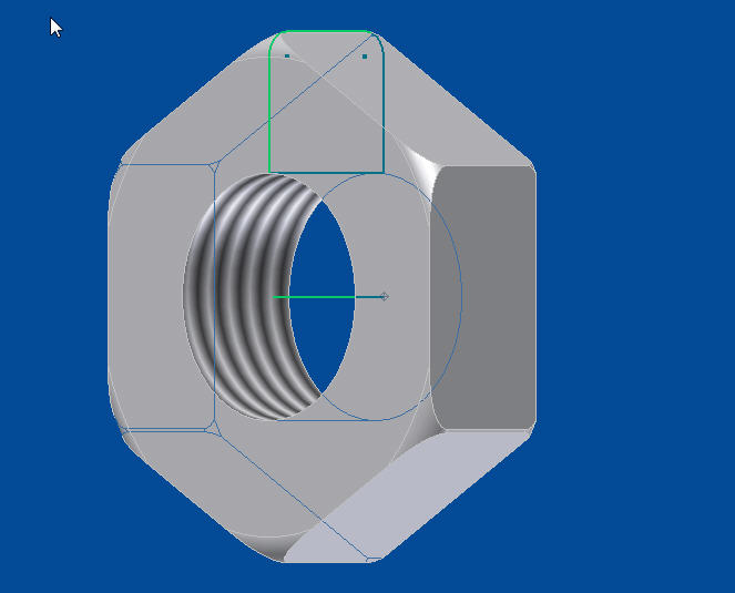

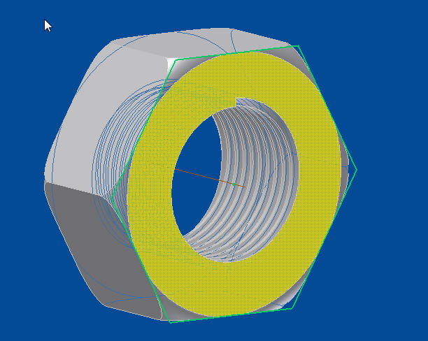

kencaz Posted July 30, 2009 Share Posted July 30, 2009 Found the site but still cant figure it, guess im gonna have a late night You can either revolve a sketch profile of the bolt with the fillet then extrude a hexagon using intersect which will give you something like this: Or, you can extrude a circle profile the desired height (in yellow), then add the fillet to your feature after, then again, extrude your hexagon using intersect. Then add either bit mapped threads or cut your own. hope this helps. KC Quote Link to comment Share on other sites More sharing options...

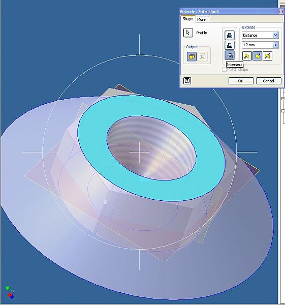

lucyislay Posted July 30, 2009 Author Share Posted July 30, 2009 thanks for the help but i cant seem to figure out how to intersect ? Quote Link to comment Share on other sites More sharing options...

czc Posted July 30, 2009 Share Posted July 30, 2009 thanks for the help but i cant seem to figure out how to intersect ? I hope this image helps. Quote Link to comment Share on other sites More sharing options...
