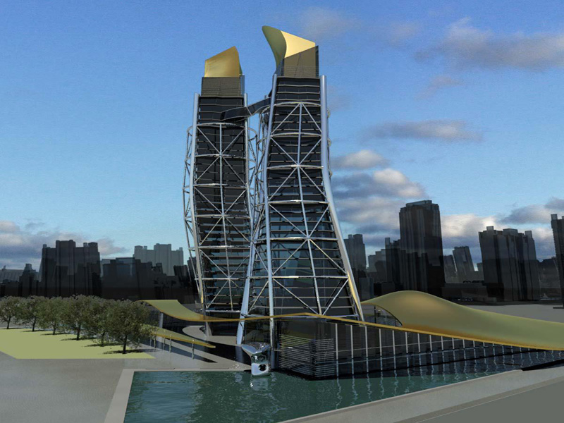

arjun_samar Posted August 1, 2009 Share Posted August 1, 2009 to all masters of autocad.... i saw this image the logo of acad 2010.. and it has waters at the bottom.... and ive tried to do the same thing the water effect.. but i just cant get it right... you can notice that the reflection of the building to the water is jagged and this gives a realistic look,, how do i do that? sorry for im locking of knowledge in this.... thanks in advance.. hope someone help!!!! Quote Link to comment Share on other sites More sharing options...

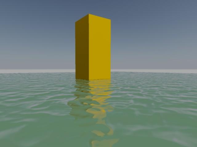

omid_221 Posted August 1, 2009 Share Posted August 1, 2009 1-setup your lighting system .(day light)+finall gather 2-nake a new material (whit in realsitic category select water) 3-go to the bump map and put noise map on it 4-in noise map select fractal reduce the size 5-if you want more complex water wave put another noise instead of black or with water.... Quote Link to comment Share on other sites More sharing options...

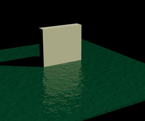

arjun_samar Posted August 1, 2009 Author Share Posted August 1, 2009 1-setup your lighting system .(day light)+finall gather2-nake a new material (whit in realsitic category select water) 3-go to the bump map and put noise map on it 4-in noise map select fractal reduce the size 5-if you want more complex water wave put another noise instead of black or with water.... sir omid, a big thanks to you!!! thank you much for your help.. here just trying out your tutorial:twisted: Quote Link to comment Share on other sites More sharing options...
omid_221 Posted August 2, 2009 Share Posted August 2, 2009 very good but you lighting is not ready for that.try using sun and sky Quote Link to comment Share on other sites More sharing options...
