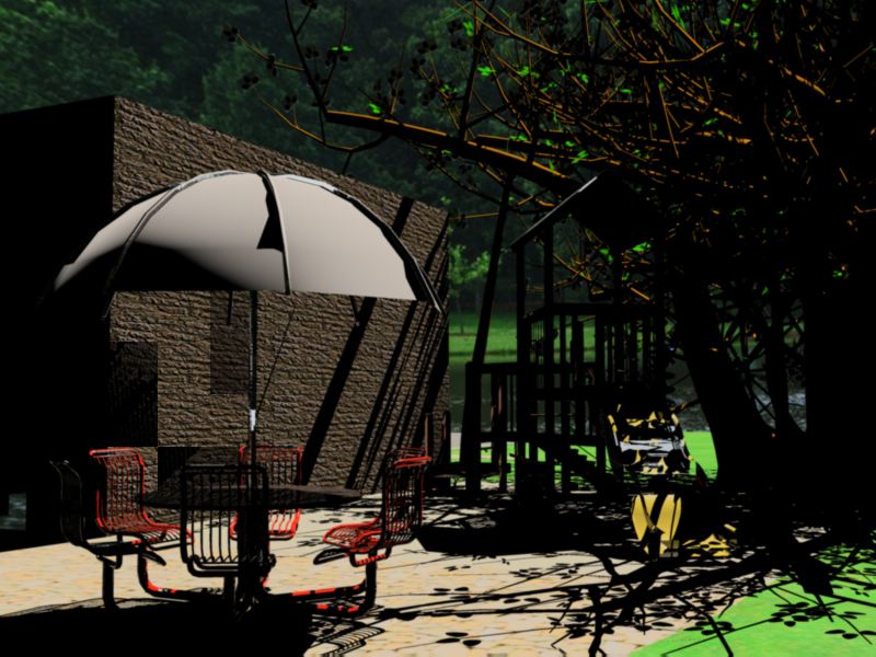

using viz 2007 this render comes out to dark and the maps don't look like they should I used mental ray settings, can someone give me some insight on how to fix this? Still very new to this...
If your using mental ray, i think this problem is under the daylight modifier>mr sky>on, if it still is a bit dark increase its multiplier settings. ill try to update with a screenshot.
Also turn on your Indirect Illumination (GI ) in render settings
Thank you Indirect Illumination is what helped now just have to play with settings thanks again.
I use max though assume you've got most of the functions. Perhaps one or two bounces to your light in the GI render settings will improve the scene.
Also maybe you could blur your shadows. Do a search on spotlight or MR sun depending on which you've used and find the appropriate setting.
