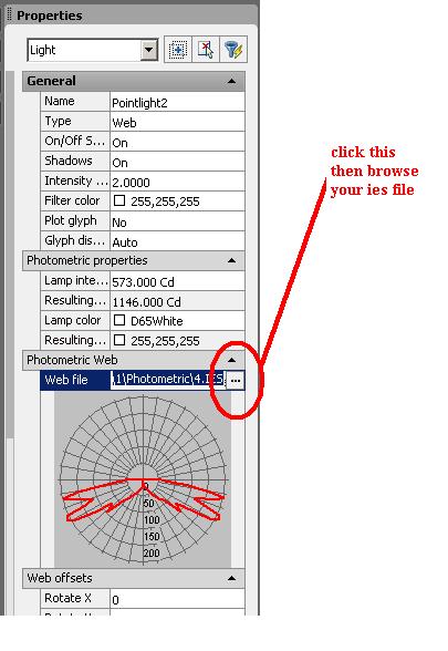

Mr. omid, i have open your model. and first thing i did was render it in your settings.. but the result was plain dark.... then i have notice that the reason why the render was plain black its because the your view is not inside the shelled 3d box... imagine a light inside a covered box.. then outside of that box have no light. so, in real world if your looking from the outside of the box all you see is just plain black.. so i have place a camera inside the box...
and place the ies file to your web light and i added some few point lights with shadows off. examine the dwg file attact its your 3d model that i examine..

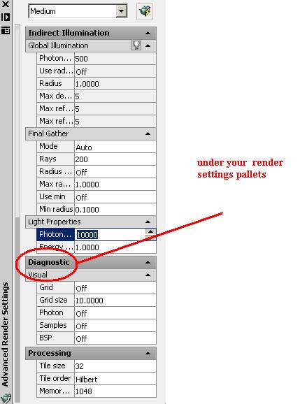

btw, where would I find this Visual Diagnostic?
here. Mr. Noaham:D

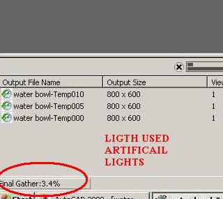

Mr. Omid is this what your talking about? , here, the 1st image is a render window
with artificial lights (ies lights and point light..
after hitting rr for render it skips photon emission
the renderer goes directly to final gather skiping the photon emission

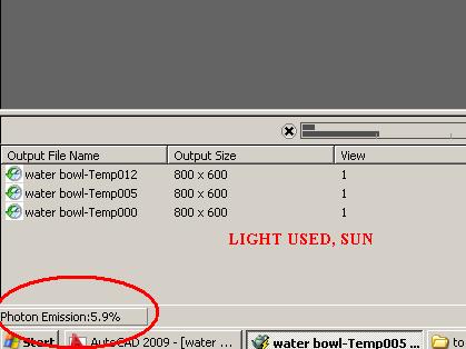

the second image, i used sun as the light and
after hitting rr for render. photon emission does appear. it doents skips it
unlike the artificial lights.(ies lights)

here. Mr. Noaham:D
ahh, thank you :)
