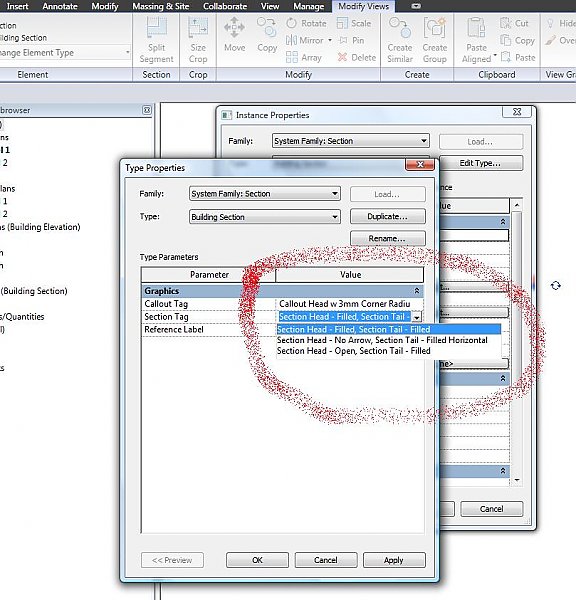

hi,
I want to change my "standard" section head to one i created myself with M_section head.rfa but i dont know what i'm doing wrong cause for some reason after loading this new family into the project its doesnt register in the project and i cant select it when editting the building section parameters it only shows the standard preloaded ones.
any help be appreciated
  • 2 months later...
Once you have loaded your section head into the project go to your manage Tab / Settings / Section Tags.
You can then change your selectio to your custom made section head.
Hope this helps
