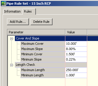

I know you can set min. cover, not sure about max. without looking. On the length I believe there is a max. length, not sure about min. length. Look around for that in your pipe rules. I'll check mine (using 2008) too.
Yeah I've seen those, I guess I'll see what possibilites for new rules there are. I don't really want to be manually adding the pipes on my plan as the lengths of each section needs to be dependant on the ground surface to allow it to follow the ground surface as closely as possible.
