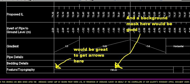

spittle Posted August 7, 2009 Posted August 7, 2009 Is this possible? I want to change the standard line that can be generated automatically in your bandsets so that they have arrows at each end. Currently I'm editting Pipe bandsets. Quote
rustysilo Posted August 10, 2009 Posted August 10, 2009 Can you post something that shows the bandsets and where you want the arrow located? Quote

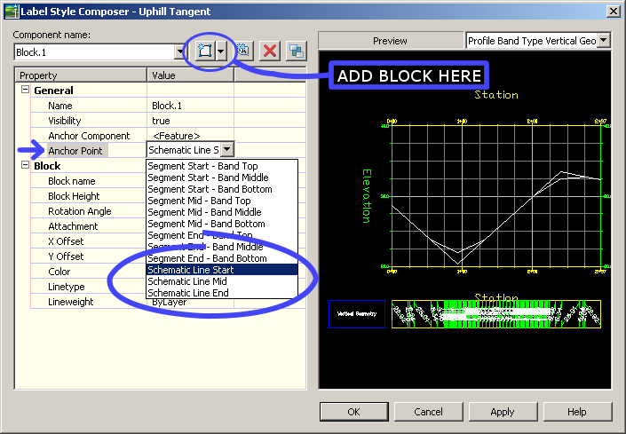

rustysilo Posted August 11, 2009 Posted August 11, 2009 It appears it may be possible in the band label style. Try adding a block to the label and use the arrowhead block with the anchor point @ the beginning and/or end of the schematic line(s). See image. You should be able to set the text background mask in there too. Quote
