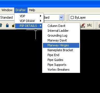

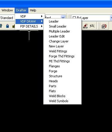

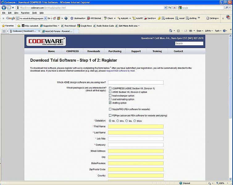

The Buzzard Posted April 3, 2010 Posted April 3, 2010 Daniel, I have some good news for you. I downloaded a trial version of Codeware drafting option. I found out that practically everything in it is available for use and there is no trial time limit on it. The programs in it are *.fas or Fast Load so they are compiled, But the program gives you more than you can imagine. Heads in 2:1, F&D and Hemispherical Welded Fittings all sizes Forged Threaded Fittings all sizes Mallable Iron Fittings all sizes Flanges all sizes Structural Steel all sizes Misc Parts Item Ballooning Welding Leader Symbols This is all available in English or SI units. See menu images below. You just need to register at this site: http://www.codeware.com/downloads/register.html At this site location you get the Drafter Manual for this software in PDF format: http://www.codeware.com/support/manuals/drafter.pdf Here is what the site looks like, notice I have clicked the drafting option. Give it a shot, This is a great deal for free. Also below are images of the drop down menu. Quote
ReMark Posted April 5, 2010 Posted April 5, 2010 The user is limited to 60" and 120" shells and 6" / 10" fittings. Quote
The Buzzard Posted April 5, 2010 Posted April 5, 2010 I downloaded the Drafter option only. I have full use of all options. Did you download Compress as well? That could be a reason why although I am not sure. The Drafter option is for CAD only and has fast load files. I seem to have gotton everything the program offers. I mentioned to click the Drafter option only. Compress is for designing the shell and nozzles. You would use the design files to generate the vessel you designed for CAD. That would most likely have a limit as to what you can do with it. The Drafting option stand-alone is what I meant to download for the CAD routines. Quote
