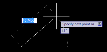

montiff Posted August 17, 2009 Posted August 17, 2009 I've tried to feed the coordinates into the command line and it works fine for the first one. It gives me 2 windows for my x and y. Once I've finished that it only now gives me distance and degrees instead of another x and y point. Quote

montiff Posted August 17, 2009 Posted August 17, 2009 Screen shot maybe hard. Here is my command line: LINE Specify first point:3150704.27, 696953.51 (now it wants me to) Specify next point or [undo] (this is where i want to add an additional point of 3150380.25,696827.47) (Here is where I get a single dynamic input or a double with a one dynamic input wanting a degree.) Quote

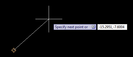

Lee Mac Posted August 18, 2009 Posted August 18, 2009 Ok, from what you are saying, I believe you are receiving something like this, only allowing a distance input, then prompting for an angle: From here you have two options, you can either switch off dynamic input, and use the command line (press F12 to do this), or you can switch the dynamic polar input to cartesian, by pressing the UP arrow. After pressing the UP arrow, you should see something like this: In my opinion, I find the Dynamic Input gets in the way and clutters the drawing space when you are trying to do something, so I don't use it, but I have provided you with both options Hope this helps, Lee Quote
