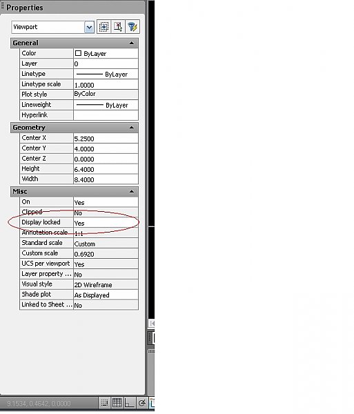

chelsea1307 Posted August 17, 2009 Posted August 17, 2009 when you click on the border of the vp and type ch you dont get the option in the red circle? Quote
chulse Posted August 17, 2009 Posted August 17, 2009 when you select the VP - it should show up... Oops... too slow... Quote
CadDan Posted August 17, 2009 Author Posted August 17, 2009 Thanks chelsea. I had to play around a bit to get to that but I finally got it. Quote
CadDan Posted August 17, 2009 Author Posted August 17, 2009 when you select the VP - it should show up... Oops... too slow... ha. It's alright. Your help, helped me get to it as well. Quote
