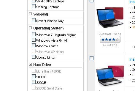

CADMASTER1128 Posted August 19, 2009 Share Posted August 19, 2009 which laptop if you don't mind me asking? I don't know off the top of my head. I will get back to you on that one... I was on the dell site and saw that XP is longer an option. See attached image: Quote Link to comment Share on other sites More sharing options...
