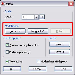

Surely the easiest way to centre the viewport is to double ckick the viewport and choose the midpoint button and scale it from there?
