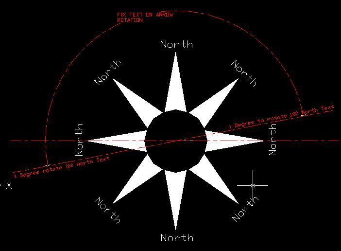

i have some question regarding with Dynamic block i have a standard block drawing a North sign, i need that the North Font will follow on point arrow rotation altough when the arrow point will rotated on 181 degrees the North Text will rotate also to 180 degrees, see image for some idea if this possible to work on Dynamic block, :)
Please kindly give me some idea on it

if I HAD to do this I think I would have 2 "North" texts @ 180 degrees and use a visibility state. I can't think if an automatic way of doing this.
Hello.
I made the txt as a block and then made a seperate block with both the arrow and text block in one.
north point.dwg

each direction a vis state = 8 ...
i would have to experiment but what about using a dimension, overriding the text with "N" as the text, and turn off all the leaders, ticks and what nots (maybe make a seperate dimstyle)?..
hey, just did a quick test and it works!!!..may have to do some tricks to hide the nodes/defpoints but you could always place them in the solid arrow section...
