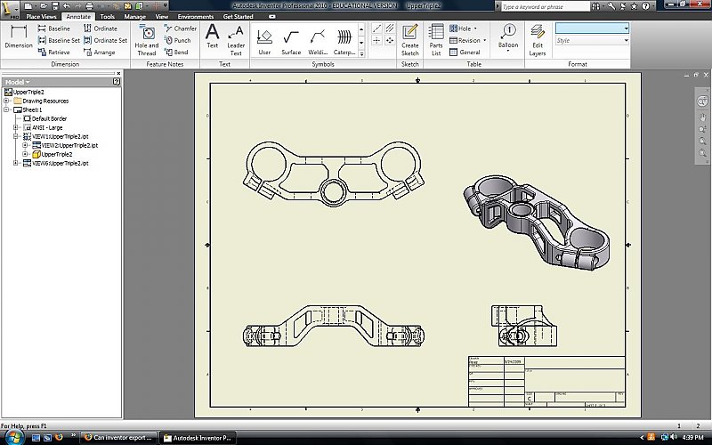

shift1313 Posted August 24, 2009 Share Posted August 24, 2009 After you mentioned that mark i went ahead and played with an inventor dwg file and sure enough layers is on the annotation tab. I also created an idw file and it was there as well with all the same functionality as far as i could tell. But i do have a question regarding this. I went through the edit layers menu and turned the visibility off on all layers and nothing changed in my drawing. Is there something wrong? Quote Link to comment Share on other sites More sharing options...
MarkFlayler Posted August 24, 2009 Share Posted August 24, 2009 Can you attach your drawing with an IPT and a screen grab? Quote Link to comment Share on other sites More sharing options...
shift1313 Posted August 24, 2009 Share Posted August 24, 2009 i didnt save anything but i will try and make one tonight when i get home and upload it. Quote Link to comment Share on other sites More sharing options...
shift1313 Posted August 24, 2009 Share Posted August 24, 2009 The first picture is an .idw file. The second picture is an .idw file before i create a base view. You can see all the layer information but once the base view is create i can no longer see this info. the zip file of the .idw was too large to upload here so i put it on my filebox. http://filebox.vt.edu/users/maperez/Cad%20Drawings/UpperTriple2.zip it is an educational version of inventor 2010 Quote Link to comment Share on other sites More sharing options...
MarkFlayler Posted August 25, 2009 Share Posted August 25, 2009 Matt, I still see layers even after placing the view in. The fact you do not is odd. I can't really do anything with your file since I do not have the IPT to reference in the file. Anything I do will be all for naught. Quote Link to comment Share on other sites More sharing options...
shift1313 Posted August 25, 2009 Share Posted August 25, 2009 That is odd mark. When i create a view and i hit the Edit Layers button i see all the layers, but they arent in the drop down box. Its not something i will be using so its not a big deal but it is interesting. Ill check all my add-ins again. maybe something isnt loaded that needs to be. Quote Link to comment Share on other sites More sharing options...
