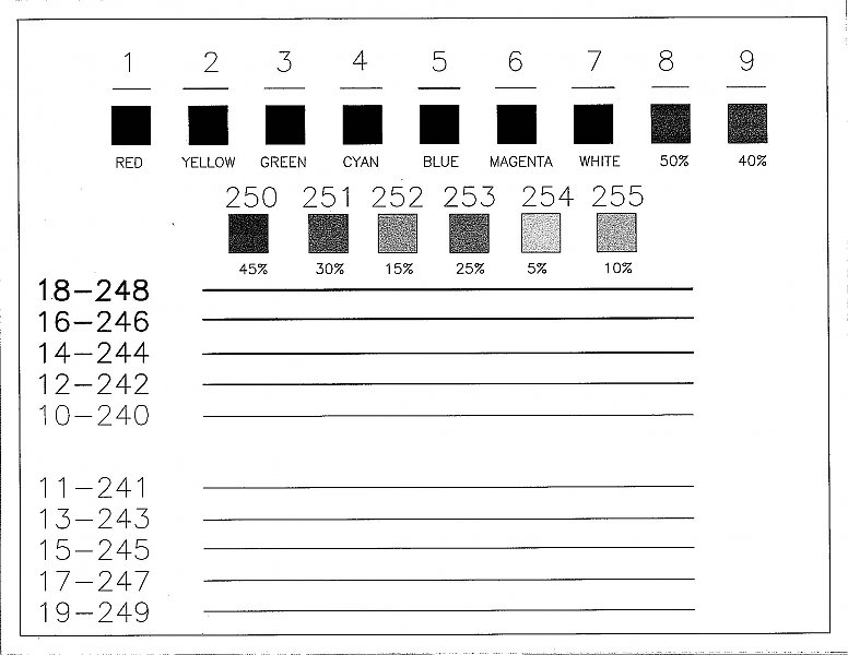

This is a very old (AutoCad 12) and very basic pen weight setup but was very affective at giving my drawings a depth of field (if you will) with background and foreground conveyance for civil design and survey drawings. Set up your CTB file as shown in the image and use heavy weights for things that need to really be noticed and medium weights for less important and then light weights to screened/shaded colors (i.e. 8, 9 & 250-255 in the image) for things that need to be seen for reference. I hope this helps.
