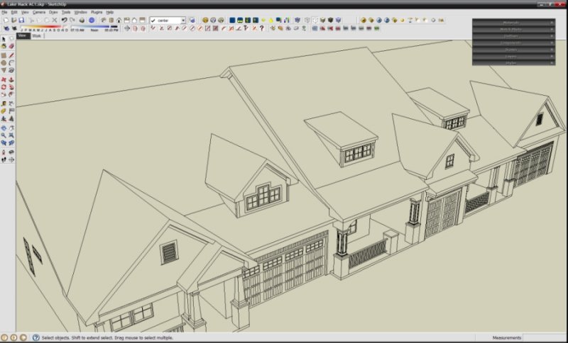

Red333 Posted September 4, 2009 Share Posted September 4, 2009 Is there an easy way to add a roof to my model in Sketchup? Right now I'm drawing line work, extruding it, and rotating it into place, which takes forever especially when trying to add a fairly complex roof to a house in excess of 4500 sq. ft. Thanks in advance. Quote Link to comment Share on other sites More sharing options...

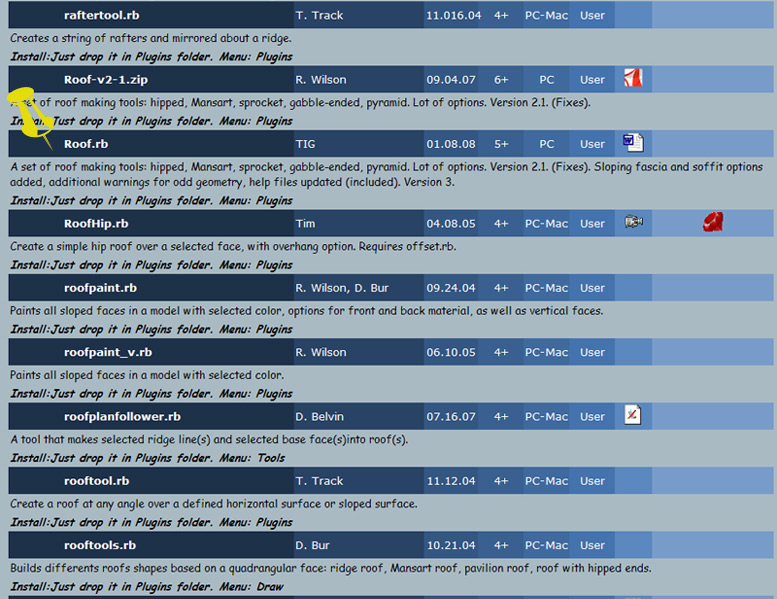

boofredlay Posted September 5, 2009 Share Posted September 5, 2009 There are a couple of roof making ruby scripts on this page (alphabetical). http://www.crai.archi.fr/RubyLibraryDepot/Ruby/en_arc_page.htm I tested the one TIG wrote years ago and it was pretty solid. However I have not used it or the other in quite a while. Hope this helps. Quote Link to comment Share on other sites More sharing options...

boofredlay Posted September 6, 2009 Share Posted September 6, 2009 The image below is what you should see. I pinned the one I used way back. Just right click on the name (Roof.rb or which ever you want to try) and save it in your Plugins folder (C:\Program Files\Google\Google SketchUp 7\Plugins). Restart SketchUp and you should have the roof tool you just added show up in either the plugins pulldown, tools pulldown or on the context click (right click). Again, I have only used the Roof.rb by TIG and that was a loooong time ago. P.S. I just noticed that the Roof.rb has a word file next to it. I opened it and there it is a real nice help file, full of graphics. Have fun. Quote Link to comment Share on other sites More sharing options...
