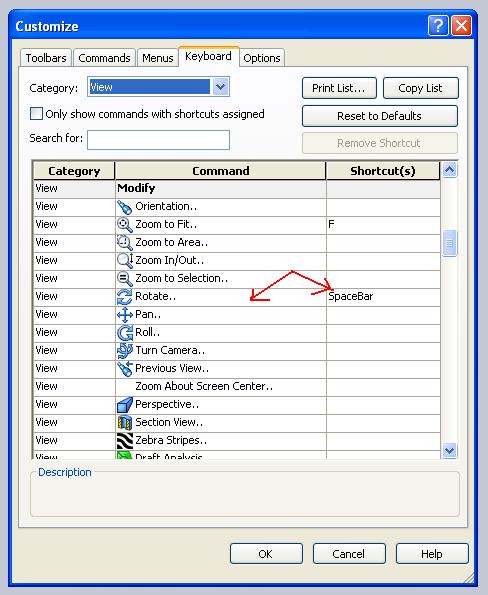

shift1313 Posted September 18, 2009 Share Posted September 18, 2009 so what is the issue exactly. You can use 3d orbit at all or you cant get it to work with some HotKey? I have 3d orbit setup so I use my space bar to turn it on/off. Did you find the Tools>customize menu? The Keyboard tab on that pop up window has a Category drop down box. When you first open it I believe it always defaults to Edit. Change it to either View or All Commands(i would go with View). If you click in the shortcut box to the right of whatever command you want you can then enter a keyboard key to assign to this operation. If there is another operation that is already using that it will ask you before changing. I added a screen shot. Quote Link to comment Share on other sites More sharing options...

Sebex Posted September 18, 2009 Author Share Posted September 18, 2009 Ye I found the option, and it does work. Only I prefer just as the mouse middle mouse buttons works (which i don't have...) So if you press spacebar the 3d orbit mode is on and you can move it with your mouse as long as you got spacebar pressed..... so if you release the camera stops moving. Quote Link to comment Share on other sites More sharing options...
shift1313 Posted September 18, 2009 Share Posted September 18, 2009 I think there is a little confusion. Are you trying to set up cameras or just rotate the part? In motion studies you insert cameras into the model and you can move cameras around. You arent talking about that right? For the way i have it set up i press the space bar(dont hold it) then 3d orbit is on, i can rotate the object around. When i press the space bar a second time it turns 3d orbit off. The key board buttons arent designed as momentary and I dont know if you can use them for that. Quote Link to comment Share on other sites More sharing options...
Sebex Posted September 18, 2009 Author Share Posted September 18, 2009 ye I mean rotating the part, (which is almost the same...) but ok, if it isn't an option to hold the key then it's ok. I can live with it. thanks though Quote Link to comment Share on other sites More sharing options...
