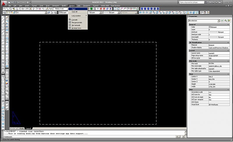

MartinSomerville Posted September 16, 2009 Author Share Posted September 16, 2009 Thanks for your replies Mark I use classic (i should have mentioned) I've attached a picture. In 2009 there were a list of drawings in this menu which I found handy...but gone as can be seen in 2010. What you described may be alternate for me if I can shortcut key to the open document part of the A corner menu. Cheers Martinnnn Quote Link to comment Share on other sites More sharing options...
ReMark Posted September 17, 2009 Share Posted September 17, 2009 I switched to AutoCAD Classic and clicked on the Window drop-down menu after opening two drawings. Both drawings are listed under the last item Arrange Icons. Like I said previously, I've haven't cutomised 2010 so this behavior is straight out of the box. Maybe you have a case of clickitis. Quote Link to comment Share on other sites More sharing options...
ReMark Posted September 17, 2009 Share Posted September 17, 2009 Just for giggles I tried that Alt+W shortcut you mentioned in AutoCAD Classic mode. It works. Maybe you have a corrupted install. Have you tried a Repair? Quote Link to comment Share on other sites More sharing options...

MartinSomerville Posted October 5, 2009 Author Share Posted October 5, 2009 hey mark. I did a repair and yep, all looks good now thanks. now I hope it stays when I start adding the office std stuff to it thanks again Quote Link to comment Share on other sites More sharing options...
MartinSomerville Posted October 5, 2009 Author Share Posted October 5, 2009 ...actually, it's gone again when I set to office profile. I think I didn't need the repair after all, it's a profile thing which is weird because it never affected 09. When I set profile to initial acad the drawings appear in the window dropdown.. Something to sort out with the customising acad manager here. thanks (edit):..and regarding the alt+w shortcut, I think that's a std windows thingy to access menus?? alt underlines some letters in the menus. Hitting that letter with alt displays the associated menu Quote Link to comment Share on other sites More sharing options...
