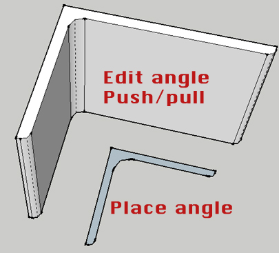

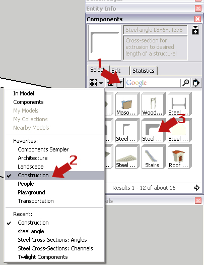

boofredlay Posted October 14, 2009 Share Posted October 14, 2009 Hello bbankston - thank you for the reply - however I was able to find out how to do this. Essentially I wanted to draw just a peice of steel - like 4" H x 36" L and .25" Thickness. Sort of using steel track bar but in an L shaped. I also might not be using the proper terminology for the steel - Either way - thank you I think you are looking for a steel angle. Just search your component browser, place the standard angle you want, edit the component and push/pull it to the length you wish. There are tons of other standard steel shapes in the Construction tab as well. Quote Link to comment Share on other sites More sharing options...
joemaddigotz Posted October 14, 2009 Share Posted October 14, 2009 It looks like your using a new version of autocad - Although Steel Angle is exactly what I was looking for thank you my friend. I guess I will have to try something close to what you told me but with AutoCAD 2006 Quote Link to comment Share on other sites More sharing options...
boofredlay Posted October 14, 2009 Share Posted October 14, 2009 Sorry for any confusion but I am using SketchUp. Edit: However, you could find the angle you want then export a 2d dwg to Autocad. Quote Link to comment Share on other sites More sharing options...
