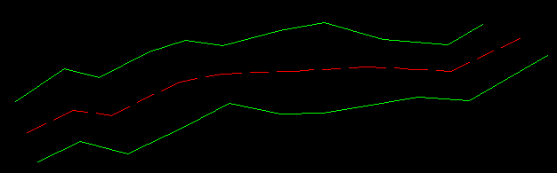

Umm, no, the given polylines are not necessarily straight. I just want a polyline, each point of which has the same distance from the 2 given polylines. This, of course, would work with straight lines too since it is a more general approach. I'm not sure if i can explain it right because my english is not that great :)
To make it more clear, i have 2 polylines that represent the banks of a river and a want to create a polyline from those two, that would represent the axis of the river.. Hope that makes it a little more clear
Ok, I think I understand, something like this:
Where the red polyline is the new one.
This would not of course be 100% accurate, as there would have to be a "sampling" of the polyline at intervals along its length.
Extactly! Yes, i know what you mean but that's not a really big problem. I guess i will figure a way to get to the desired accuracy. Do you know any ways to create such a polyline? Oh, and thanks for your interest Lee!

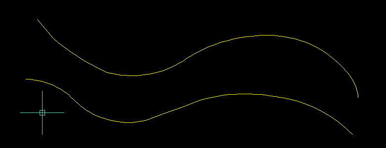

Had a bit of time, so heres an animated version o:)
(defun c:cPoly (/ ent1 ent2 i j mPt len pt p1 ptlst grlst grlin)
