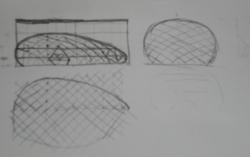

I would like to draw or pull a grid over a surface or mesh, so the projection of the grid drawn by me would stay the same if I look at the object from the top.
i hope its clear...
whole_mesh_surface.dwg
I can't really picture what your asking even with the dwg. maybe you could clarify a little.
KC
Thanks for the reply... maybe i couldn't describe the problem. I've that mesh or surface that looks like a strange egg. And than I have the grid. I would like to put the grid on the surface from the top, so if the grid is on the body, from top view you'd see a uniform grid, same as if it was planar, but from the side views it is deformed of course...
i hope its clear enough now, it would be nice if you could help me solving this...
something like on the attached sketch
I can’t open the file attached in post #1 (2010 format, presumably), but if a SURFACE is indeed available – not just some sort of mesh – then there may be the option to THICKEN the surface into a solid, create a grid of Regions, and IMPRINT the Region/Solid intersections. A bit of a pain, but not that bad.

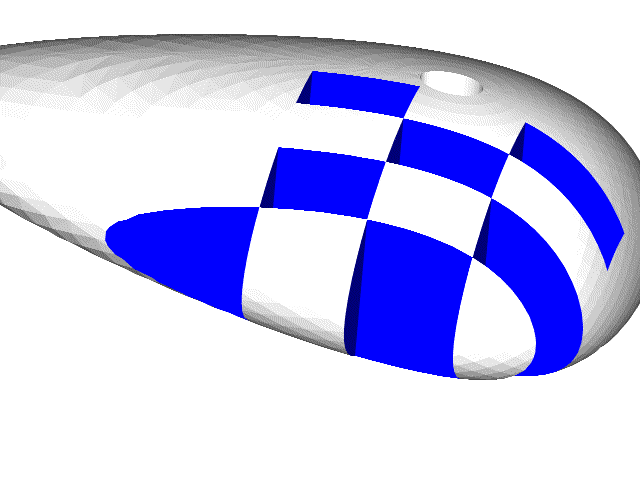

Sadly, that is a mesh and not compatible with the THICKEN or IMPRINT command.
However, with the “DEFAULT” layer present, I’m inclined to believe Rhino3d was part of the workflow. If that is the case then Rhino can generate the grid with its “Contour” command. See sample.
Grid.dwg
Wow!
That's exactly what i was looking for! :)
I've been trying to do this since 2 days... I think i owe you a few beers! 8)
Thanks a lot!!!
btw, yes, Rhino and some other software(VR Mesh, SurfX3D) was involved for getting the point cloud from some parametric equations...
