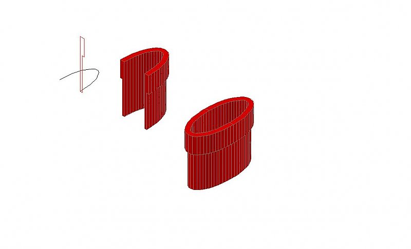

I took a slightly different approach by using the EXTRUDE command. I did it for one-half of an ellipse then mirrored it. This is the result. Would this approach be acceptable to you?

Revolve works on a fixed point and will take your linework and spin it around that central point, much like a pottery wheel. You cannot create irregular shaped objects with Revolve.
Using 2006, you will need to Extrude along a path as in ReMark's example.
