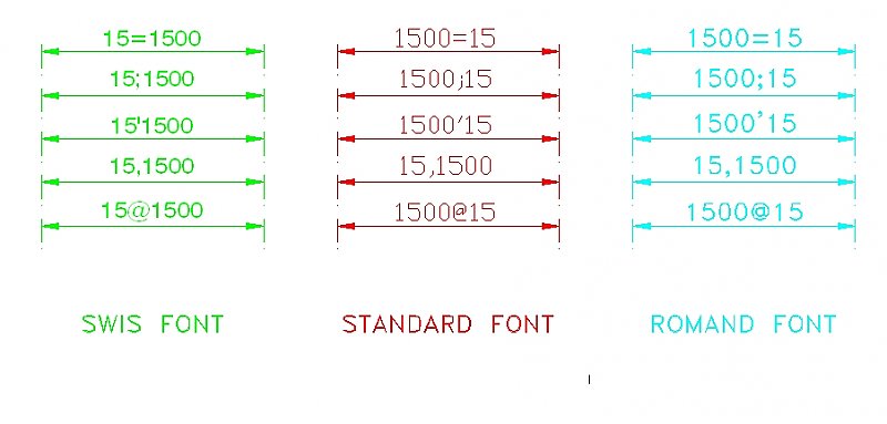

We are using AutoCAD2007 in our office. In some computers we have a strange problem that when we type '15@1200' as dimension text, it displays as '1200@12'. This happens only with numbers. If I type 'a@b' it doesn't change. The same happens with mtext also. It happens also with other special charecters like = , ' ;
Anybody has any idea about this problem?

Is the measurement actually 1500? i.e. are you writing "15@" or "15@1500"?
Thanks for the response.
Only 2 computers are having this problem while more than 50 are working fine.
This is not because of the text override because the same thing happens in Mtext also. The value was fully typed from keyboard, it is not the actual dimension.

are those 2 machaines always playing up, every time you use an @ symbol or only with certain numbers?
The 2 machines are having problem always, and it is OK when I use some true type fonts but not all true type fonts.
In the case of Mtext, if I list the object, it is showing correctly. Only in the display of text it shows wrongly. When I open the same drawing in a different machine it shows properly.
real long shot here..... does it print as it displays or by some miracle does it print correctly?
From that machine it prints the same way it displays the text.

In the 'Advanced' tab of 'Regional and Language Options' the language selected was 'Arabic (Saudi Arabia)'. When I changed it to English (UK) everything is OK.
A little history for those who are interested....
I was able to re-create the problem from your hint. While you are in the Mtext editor, if you select the text, right click and change the 'charecter set' to 'Arabic' then the text will change the order.
I noticed that the value of system variable 'SYSCODEPAGE' is 1252 in my PC while in the troubled PC it is 1256.
