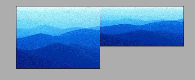

eldon Posted November 2, 2011 Share Posted November 2, 2011 Of course there is another method that does not involve making an intermediary block - Rotate 3D. If you rotate 3D about the X or Y axis, it has the effect of fore-shortening the image. Just what you want. Quote Link to comment Share on other sites More sharing options...
