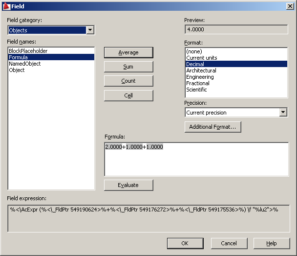

I am trying to create a live dimension total tool eliminate. This total should be displayed in the drawing (as shown). I have experimented with "fields" in text, using dimensions in dynamic blocks, and so forth but cannot find the right solution.
Any help would be greatly appreciated! :?

You can use a formula field, then insert object fields into the formula.
I was going to upload, but I couldn't get it smaller than 250k.
That is great advice, I wasn't sure at first but I figured it out.
