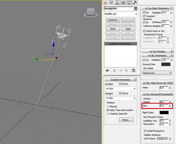

Im just trying to get rid of the gray, where the horizon mets the plane, i can move the plane but in the real model the block will be replaced with a house and trees etc I have to animate a camera moving around it and the gray horizon becomes very clear in some shots.
To get rid of that blurry grey band at the horizon, adjust the Blur amount under the "mr Sky Advanced Parameters" section in the Daylight System's Modifier panel. A setting of 0.0 will make the horizon completely sharp. Refer to the screenshot below.
Thank you so much Cad64, I knew it would to be relatively simple.
Your helping me quite a bit with this assignnment!!
