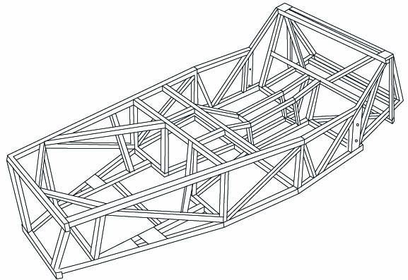

Styk here's an example of what I draw alot, this is a chassis bases on the Low Cost 7 I've been working on building one for 3-4 years, I've almost got enough parts and tubing to start building the chassis. A little Lotus 7 Clone with a real fast Toyota 4age 156 valve motor is going to be a neat little daily driver, and the key is all junkyard parts :) and yes I know it's more a Diametric than an Isometric drawing :)
Richard, thats not a simple iso..:? , are you sure 3D wouldn't be more suited,
especially when it came to BOMs and steel detail drawings
I have to agree with PS_Port on his comment. When you're doing projects such as this, Iso is not the best choice. Iso is good for visualization, and not necessarily accuracy. 3D is where you need to be for 100% accurate representation of your drawing.

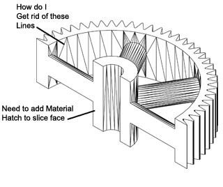

Styk, I agree I Draw a lot of 3D solids to "Test Fit", and "Pseudo assemble" different assemblies. But where I'm at right now is I have a hard time with shading a Part after I section a solid. Like if you were to take a gear solid Model and slice it how would you shade the face where you sliced it ? Ohh Hey I got this this morning thought it might give you a laugh :

Any how I did this "QUICK SKETCH" and yes the Gear Pitches are not right I did not spend the time to do the math. but this might illustrate some of the problems I'm having with solid models
Drawing the model is not the problem as much as getting the right Shading/ Hatch. I can draw Solids Fast and easy
Try using the FLATSHOT command. :)
