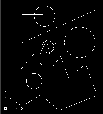

Hudson Posted October 30, 2009 Posted October 30, 2009 Ok, the latest thing to stump me is this: I have a circle and a line. They may intersect, which is easy to handle, but they might not.. if they don't I'd like to find the closest point on the line to the circle. Any help would greatly be appreciated thanks! Quote

devitg Posted October 31, 2009 Posted October 31, 2009 At least you are getting stuck on interesting things I can help you out a bit. If the two objects are intersecting this will tell you the co-ordinates (let me know if you want any explaining): (defun c:ints (/ obj1 obj2) (setq obj1 (vlax-ename->vla-object (car(entsel))) obj2 (vlax-ename->vla-object (car(entsel)))) (if (setq int (vlax-invoke obj1 'intersectWith obj2 acExtendNone)) (princ int) (princ "Not Intersecting.")) (princ) ) To get the closest point between the two have a look at vlax-curve-getClosestPointTo which will give you the closest point between a point and an object (whether it be a line or a circle). I've seen it used between two objects somewhere but I can't remember sorry, others will I'm sure. Just do it so , by lisp Select the line,and the circle. get the closest point from circle center to line obj, (vl-load-com) (setq line (Car (entsel "LINE"))) (setq line-obj (vlax-ename->vla-object line)) (setq circle (car (entsel "circle"))) (setq circle-center (code 10 circle)) (setq line-point ( vlax-curve-getclosestpointto line-obj circle-center)) (setvar 'osmode 0) (command "_line" circle-center line-point "") Quote

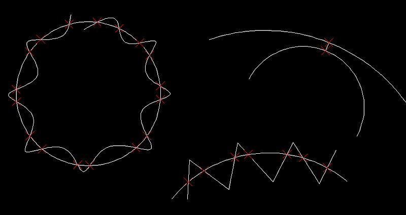

alanjt Posted October 31, 2009 Posted October 31, 2009 I was bored this morning waiting on the wife to wake up, so I decided to throw this together. I didn't get a chance to post it earlier since we had to pick up a load of scrap iron for a huge art project we're doing at her school. I got a little carried away, but enjoy. Oh yeah, you will need my AT:Entsel function: http://www.cadtutor.net/forum/showpost.php?p=271389&postcount=26 Quote
