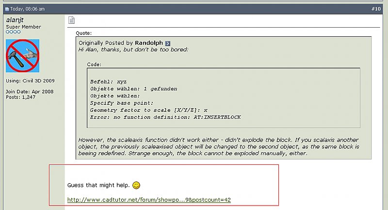

What are the bugs with XYZ? You never gave a response after I posted the link to the subroutine.
Oh yes, i did give response, right after you posted your gif animation. Quote:
Hi Alan, thanks, but don't be too bored:
Befehl: xyzObjekte wählen: 1 gefundenObjekte wählen:Specify base point:Geometry factor to scale [X/Y/Z]: xError: no function definition: AT:INSERTBLOCK

I responded to that like 8 hours ago.
Ah, ok, that was when I was in trouble at work.
So I copy&paste both your xyz.lisp and insertblock somewhere into my general acad.lisp?

Just stick it in the same .lsp file as XYZ.

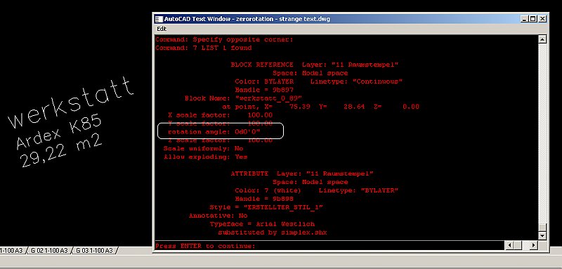

PS: I also add the long promised "strange text" that won't be rotated by zerorotation.lsp.
zerorotation - strange text.dwg

Thanks for posting the object. It's not ZeroRotation, your block (not text) has the attributes rotated within the block definition. You would need to fix the block.

Concerning the block, I imported it from a drawing I got. I even think it originates from another application.
