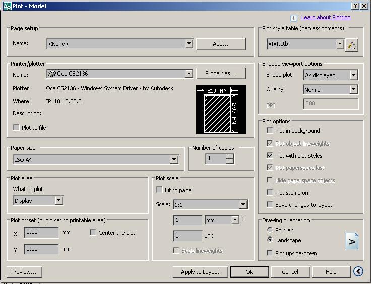

noobcader Posted November 4, 2009 Posted November 4, 2009 How do you print lifesize on AutoCAD 2010? I know there is scaling but I want to print the thing at the size I made it ie. I drew a line at 2in I want it to come out 2in when I print it Quote
viviancarvalho Posted November 4, 2009 Posted November 4, 2009 Noob While printing you just need to set the scale at 1:1. Thats it. Quote
