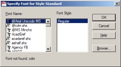

I used to get the same prompt regarding the font upon start up as I am getting now regarding the shape file.
Thanks
I used to get the same prompt regarding the font upon start up as I am getting now regarding the shape file.Thanks
AutoCAD will only prompt for a font when FONTALT is not set and the font cannot be found, and even then the prompt is different. It's not a standard windows file selection dialog. The font prompt looks like this:
