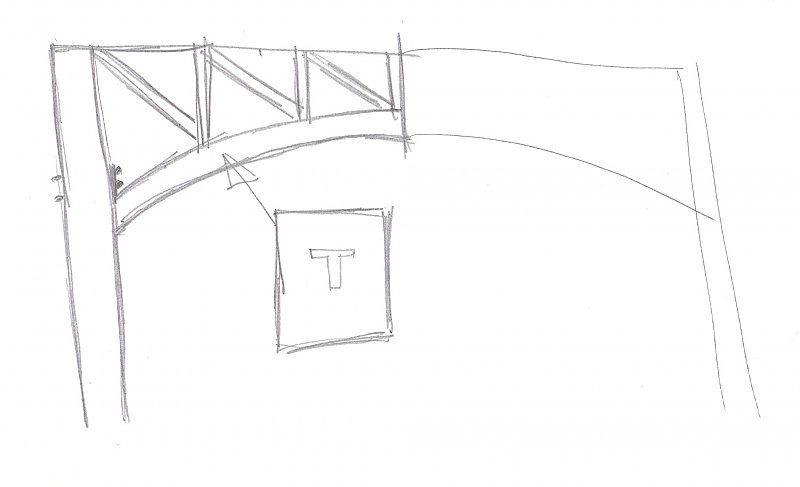

midwinter7 Posted November 6, 2009 Posted November 6, 2009 Hi everyone. I'm a second year Civil Engineering student. For a upcoming project - in which I we need to re-create 'anything to do with engineering' - i've decided to draw a structure at my local trian staton. I need to draw an arch made up of a t-beam and i'm a bit stuck with how to draw in in CAD. I'm using architecture 2010, I've tried searching for simular posts but can't find anything. I really appreciate your help guys. Andy Quote

midwinter7 Posted November 6, 2009 Author Posted November 6, 2009 tankman - yeah, that's what i meant by a t-beam. A simple I beam, but to form two t beams. I made a sketch fo the structure yesterday before I got on the train so I simply need to copy it in CAD. I like the older structures and the character is shows. ReMark - in 3D. This rough sketch shows briefly what I mean Quote

ReMark Posted November 6, 2009 Posted November 6, 2009 Draw your shape then either using Sweep or Extrude commands reproduce it over the length of an arc. Where are you located? Are we doing this in Imperial or Metric units? Quote
midwinter7 Posted November 6, 2009 Author Posted November 6, 2009 Draw your shape then either using Sweep or Extrude commands reproduce it over the length of an arc. Where are you located? Are we doing this in Imperial or Metric units? In the UK, down in Plymouth to be exact. I'll try the extrude command, i'm not quite sure who I didn't think of it to be honest. Thanks for your replies Quote

Tankman Posted November 6, 2009 Posted November 6, 2009 Andy: Keep in mind the length of the "T-Beam" must be cut longer than desired. Because the bottom two rollers are spaced, each end will have a flat. The flat is cutoff, as required (length and angle) and mounting brackets welded to mount the arch. While this fabrication know-how isn't needed, it may help thinking about the designing phase of the project. I-BEAM-ROLL-2.dwg Quote
