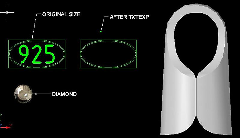

ica_cici Posted November 7, 2009 Posted November 7, 2009 Hi it's me again! I has two questions need to be solved. The first question is about 3d text. I used to work with metric, but when i start to explode the plain text using txtexp command it turns to smaller than the original size. It has to scale by 25.4 order to getting back the original size. The question is there a way to set txtexp command in metric? The second question is about tool pallet. I'm trying to draw a diamond and need to make it in 3d, but don't have the clue about the material apply for so it will look sparkling. Can i import a jpg image of diamond to the material center/tool pallet and use it as base material or is there another way for it? Need advice please! Thanks. Quote

ica_cici Posted November 9, 2009 Author Posted November 9, 2009 I've been trying all available tool pallets but none of its match for the diamond, is there a way to make a new pallet with glass material? here is the drawing file cad64!. No, it's not an annotative alanjt. Although i set it in annotative i still need to scale it with 25.4. txtexp.zip Quote

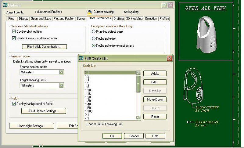

ica_cici Posted November 13, 2009 Author Posted November 13, 2009 It's also happen when i solprof an object. I should set the block & insert to inch to get the actual size, but if it set to mm I need to scale it by 25.4. Although my default settings are set to mm. What's wrong with my setting? Quote
