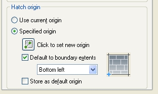

I don't have your lodgestone pattern but when I tried it with gravel, down in the bottom left of the hatch window there is a section (in 2010) that lets you pick a new orgin for your hatch.
So you would have to hatch each section of the house individually rather than all at the same time, and pick a different orgin for each one.
Looking at the DWG you posted, I think I understand what you're saying. Rather than doing one hatch for the entire facade, I'd try to separate them into a few different hatches. For example, do one hatch area for the chimney, one hatch area for the front of the house, one hatch area for the garage area, etc. Then you can just adjust the origin (HATCHEDIT command) for each area to make sure they don't line up.
Thanks Gents, just did what Glen suggested - worked a treat. Now its much easier to see the different vertical planes of the front elevation. With no one to ask except the forum, I can spend hours chasing my tail trying to get things to work.
