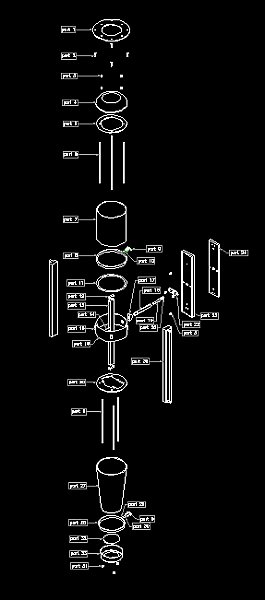

verbena1 Posted November 14, 2009 Share Posted November 14, 2009 my question is how to present an assembly drawing and/or exploded view, after i have completed the detailed (dimensioned) parts- in AutoCAD 2009 VERSION. Quote Link to comment Share on other sites More sharing options...
Tankman Posted November 14, 2009 Share Posted November 14, 2009 Some technical yada, yada, yada. Numbered detailed parts. I don't really hear the question? If you need to present the assembly, do so. Quote Link to comment Share on other sites More sharing options...
verbena1 Posted November 14, 2009 Author Share Posted November 14, 2009 If I Work In Solid Works That Is Fine To Make The Assembly Of Parts. But, When I Work In autocad 2009, I Do Not Know How Two Create The assembly Drawing Of Some Parts. Which Area I Need To Work,and What Commands I Need To Use For That ? Quote Link to comment Share on other sites More sharing options...
lulumara Posted November 14, 2009 Share Posted November 14, 2009 Only on Solidworks that you can have an Assembly drawing but not in AutoCad. Quote Link to comment Share on other sites More sharing options...
paulmcz Posted November 14, 2009 Share Posted November 14, 2009 my question is how to present an assembly drawing and/or exploded view, after i have completed the detailed (dimensioned) parts- in AutoCAD 2009 VERSION. Create the assembly in 3D and then make the exploded view Quote Link to comment Share on other sites More sharing options...
Tankman Posted November 14, 2009 Share Posted November 14, 2009 Create the assembly in 3D and then make the exploded view Now, that's talking! Keep it simple, work smart! I've been at this too long, 40+ years but, never work with 3D. All my work plan and elevation views. Through in a bit is isometric views and I'm good to go. I can still list out the parts similar to your posted drawing. Clean view. Quote Link to comment Share on other sites More sharing options...
