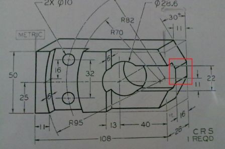

jafranco Posted November 17, 2009 Author Share Posted November 17, 2009 thanks.someone started a thread last week titled"help me plz with my homework".there was a 3d drawing there.was trying to draw it but couldnt get it right.not really good with viewports[dont know if it would have helped in this case though],i extruded the plan view after filleting the edge at 30 deg.succeeded in getting the groove on d drawing.but then i got stuck.i guesss i didnt follow d right steps.i would really appreciate it if u could help me break the process down.thks a bunch Quote Link to comment Share on other sites More sharing options...

jafranco Posted November 17, 2009 Author Share Posted November 17, 2009 d drawing is attached Quote Link to comment Share on other sites More sharing options...
ReMark Posted November 17, 2009 Share Posted November 17, 2009 The process differs from person to person depending on their approach to the problem and the commands and combination of commands they use. Where exactly did you get stuck? The holes and notch have to be subtracted from the remainder of the extruded object. Quote Link to comment Share on other sites More sharing options...

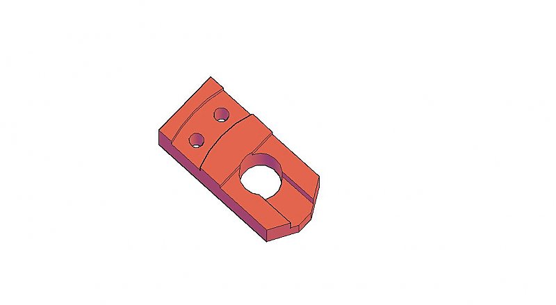

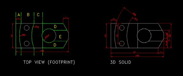

eric_monceaux Posted November 17, 2009 Share Posted November 17, 2009 I agree with ReMark. If you draw the rear (using current orientation) of this piece as the "footprint" and extrude the various elements, you could build this rather quickly. The real challange (if you choose to accecpt it) is creating this using faces, without using a solid (and then just exploding it)....and maintain the hair count on your head, that would be something! Quote Link to comment Share on other sites More sharing options...
