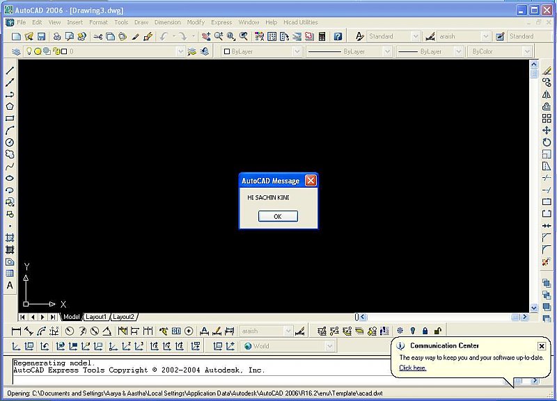

sachindkini Posted November 17, 2009 Posted November 17, 2009 Dear All, after the open acad i want startup with alert box "Hi abcd" (Login name) "Good morning " " Good Afternoon" "Good Eveing" , Date & time Quote

sachindkini Posted November 17, 2009 Author Posted November 17, 2009 dear sir, thx for reply sorry for poor english i want pop up alert box open cad in morning say "good morning" open cad in afternoon say "good afternoon" open cad in evening say "good evening" & night "good night" find attached Quote

autolisp Posted November 18, 2009 Posted November 18, 2009 (setq usernm (getenv "username")) (setq ttdt (rtos (getvar "cdate") 2 4)) (setq year (substr ttdt 1 4)) (setq month (substr ttdt 5 2)) (setq day (substr ttdt 7 2)) (setq hourms (substr ttdt 10 2)) (setq mints (substr ttdt 12 2)) (setq hourm (atoi hourms)) (if (> hourm 12) (setq houri (- hourm 12)) (setq houri hourm)) (if (> hourm 12) (setq ampm "pm") (setq ampm "am")) (setq hour (itoa houri)) (setq alrtxt (strcat "Hello " usernm "\n" month "-" day "-" year " " hour ":" mints ampm)) (vlr-beep-reaction) (alert alrtxt) Quote
autolisp Posted November 18, 2009 Posted November 18, 2009 (setq alrtxt (strcat "Hello " usernm "\nDate:" month "-" day "-" year "\nLogin time- " hour ":" mints ampm)) Quote
asos2000 Posted November 18, 2009 Posted November 18, 2009 autolisp great How could we add this checkbox? Quote
David Bethel Posted November 18, 2009 Posted November 18, 2009 You cannot add the check box with a call to (alert) you would have to make a full blown DCL and a good bit of coding. -David Quote
alanjt Posted November 18, 2009 Posted November 18, 2009 You cannot add the check box with a call to (alert) you would have to make a full blown DCL and a good bit of coding. -David Then just store the checkbox variable with setenv. Quote
autolisp Posted November 19, 2009 Posted November 19, 2009 dear see the code any one help me commress this code (setq usernm (getenv "username")) (setq ttdt (rtos (getvar "cdate") 2 4)) (setq year (substr ttdt 1 4)) (setq month (substr ttdt 5 2)) (setq day (substr ttdt 7 2)) (setq hourms (substr ttdt 10 2)) (setq mints (substr ttdt 12 2)) (setq hourm (atoi hourms)) (if (> hourm 12) (setq houri (- hourm 12)) (setq houri hourm)) (if (> hourm 12) (setq ampm "pm") (setq ampm "am")) (setq hour (itoa houri)) (setq greet "Morning") (if (and (>= hourm 12) (< hourm 18)) (setq greet "Afternoon")) (if (and (>= hourm 18) (<= hourm 23)) (setq greet "Evening")) (setq alrtxt (strcat "Welcome " usernm "\nGood " greet "\nDate: " day "-" month "-" year "\nLogIn Time " hour ":" mints ampm)) (vlr-beep-reaction) (alert alrtxt) Quote
autolisp Posted November 19, 2009 Posted November 19, 2009 dear (setq usernm (getenv "username")) (setq ttdt (rtos (getvar "cdate") 2 4)) (setq year (substr ttdt 1 4)) (setq month (substr ttdt 5 2)) (setq day (substr ttdt 7 2)) (setq hourms (substr ttdt 10 2)) (setq mints (substr ttdt 12 2)) (setq hourm (atoi hourms)) (if (> hourm 12) (setq houri (- hourm 12)) (setq houri hourm)) (if (> hourm 12) (setq ampm "pm") (setq ampm "am")) (setq hour (itoa houri)) (setq greet "Morning") (if (and (>= hourm 12) (< hourm 18)) (setq greet "Afternoon")) (if (and (>= hourm 18) (<= hourm 23)) (setq greet "Evening")) (setq alrtxt (strcat "Welcome " usernm "\nGood " greet "\nDate: " day "-" month "-" year "\nLogIn Time " hour ":" mints ampm)) (vlr-beep-reaction) (alert alrtxt) plz help me above the code. alert box all text will be centered & font Size increase, bold & color Quote

TimSpangler Posted November 19, 2009 Posted November 19, 2009 dear alert box all text will be centered & font Size increase, bold & color This won't happen with an alert or with straight dcl. At least not without some skill and a whole lot of code. Quote
