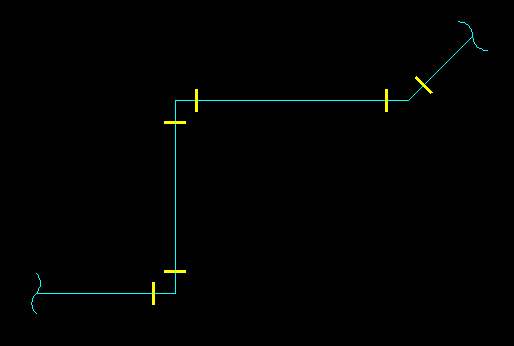

tzframpton Posted November 20, 2009 Share Posted November 20, 2009 I think I've seen it before, but basically it's a LISP that creates the mitered 90° and 45° (well, any angle ° for that matter) Pipe symbol for single line plan view on a PLINE. Attached in the image shows an example, when you draw the PLINE it puts the corresponding symbol along the run at each angle run (highlighted in Yellow). Anyone know where I can find it? Once again, greatly appreciated to anyone who can lend a helping hand. Quote Link to comment Share on other sites More sharing options...
fixo Posted November 21, 2009 Share Posted November 21, 2009 I think I've seen it before, but basically it's a LISP that creates the mitered 90° and 45° (well, any angle ° for that matter) Pipe symbol for single line plan view on a PLINE. Attached in the image shows an example, when you draw the PLINE it puts the corresponding symbol along the run at each angle run (highlighted in Yellow). Anyone know where I can find it? Once again, greatly appreciated to anyone who can lend a helping hand. Here is a quick and dirty simple lisp hope it will get you started C'mon would't to be lazy (defun C:demo(/ ang1 ang2 points elist endang tick p1 p1r p1u p2 p2r p2u p3 p4 pline pmid pt1 pt2 startang) (setvar 'osmode 0) (setvar 'cecolor "blue") (setvar 'plinewid 0) (command "._pline") (while (= 1 (logand 1 (getvar 'cmdactive))) (command pause)) (setq pline (entlast) points (vl-remove-if (function not) (mapcar (function (lambda (x) (if (= 10 (car x)) (cdr x)))) (setq elist (entget pline)) ) ) tick 25.4 ;<-- ticks length ) (setq startang (angle (car points) (cadr points)) endang (angle (nth (- (length points) 2) points) (last points)) ) (setq p1 (polar (car points) (+ startang (/ pi 2)) (/ tick 2)) pmid (mapcar (function (lambda (a b) (/ (+ a b) 2))) (car points) p1) p2 (polar pmid (+ startang pi) (/ tick ) p4 (polar (car points) (- startang (/ pi 2)) (/ tick 2)) pmid (mapcar (function (lambda (a b) (/ (+ a b) 2))) (car points) p4) p3 (polar pmid startang (/ tick ) ) (setvar 'cecolor "cyan") (command "_spline" p1 p2 p3 p4 "" p1 p4 "") (setq p1 (polar (last points) (+ endang (/ pi 2)) (/ tick 2)) pmid (mapcar (function (lambda (a b) (/ (+ a b) 2))) (last points) p1) p2 (polar pmid (+ endang pi) (/ tick ) p4 (polar (last points) (- endang (/ pi 2)) (/ tick 2)) pmid (mapcar (function (lambda (a b) (/ (+ a b) 2))) (last points) p4) p3 (polar pmid endang (/ tick ) ) (command "_spline" p1 p2 p3 p4 "" p1 p4 "") (setvar 'cecolor "yellow") (while (> (length points) 2) (setq ang1 (+ (angle (car points) (cadr points)) pi) ang2 (angle (cadr points) (caddr points)) pt1 (polar (cadr points) ang1 tick) p1u (polar pt1 (+ ang1 (/ pi 2)) (/ tick 2)) p1r (polar pt1 (- ang1 (/ pi 2)) (/ tick 2)) pt2 (polar (cadr points) ang2 tick) p2u (polar pt2 (+ ang2 (/ pi 2)) (/ tick 2)) p2r (polar pt2 (- ang2 (/ pi 2)) (/ tick 2)) ) (setvar 'plinewid (/ tick ) (command "._pline" "_non" p1u "_non" p1r "") (command "._pline" "_non" p2u "_non" p2r "") (setq points (cdr points)) ) (princ) ) ~'J'~ Quote Link to comment Share on other sites More sharing options...

stevesfr Posted November 21, 2009 Share Posted November 21, 2009 Allright, let me know what you need to change -I'll do it completely ~'J'~ Sorry to report, this is what I get.... Command: demo ._pline Specify start point: Current line-width is 0.0000 Specify next point or [Arc/Halfwidth/Length/Undo/Width]: Specify next point or [Arc/Close/Halfwidth/Length/Undo/Width]: Specify next point or [Arc/Close/Halfwidth/Length/Undo/Width]: Command: ; error: bad argument type: 2D/3D point: nil blue lines, nothing else Quote Link to comment Share on other sites More sharing options...

Lee Mac Posted November 22, 2009 Share Posted November 22, 2009 Try this Steve, (defun C:pipe (/ *error* ang1 ang2 cec elist endang osm p1 p1r p1u p2 p2r p2u p3 p4 pline pmid points pt1 pt2 pwid startang tick) (defun *error* (msg) (if (vl-position msg '("console break" "Function cancelled" "quit / exit abort" ) ) (princ " >> Error occurs!") (princ msg) ) (command "._undo" "_E") (if osm (setvar "osmode" osm)) (if cec (setvar "cecolor" cec)) (if pwid (setvar "plinewid" pwid)) (setvar "cmdecho" 1) ) (command "._undo" "_BE") (setq osm (getvar "osmode")) (setvar "osmode" 0) (setq cec (getvar "cecolor")) (setvar "cecolor" "cyan") (setq pwid (getvar "plinewid")) (setvar "plinewid" 0) (setvar "cmdecho" 0) (command "._pline") (while (= 1 (logand 1 (getvar "cmdactive"))) (command pause)) (setq pline (entlast) points (vl-remove-if (function not) (mapcar (function (lambda (x) (if (= 10 (car x)) (cdr x)))) (setq elist (entget pline)) ) ) tick 2.5 ;<-- ticks length ) (command "._zoom" "_O" pline "") (setq startang (angle (car points) (cadr points)) endang (angle (nth (- (length points) 2) points) (last points)) ) (setq p1 (polar (car points) (+ startang (/ pi 2)) (/ tick 2)) pmid (mapcar (function (lambda (a b) (/ (+ a b) 2))) (car points) p1) p2 (polar pmid (+ startang pi) (/ tick ) p4 (polar (car points) (- startang (/ pi 2)) (/ tick 2)) pmid (mapcar (function (lambda (a b) (/ (+ a b) 2))) (car points) p4) p3 (polar pmid startang (/ tick ) ) (setvar "cecolor" "blue") (command "_spline" "_non" p1 "_non" p2 "_non" p3 "_non" p4 "" "" "") (setq p1 (polar (last points) (+ endang (/ pi 2)) (/ tick 2)) pmid (mapcar (function (lambda (a b) (/ (+ a b) 2))) (last points) p1) p2 (polar pmid (+ endang pi) (/ tick ) p4 (polar (last points) (- endang (/ pi 2)) (/ tick 2)) pmid (mapcar (function (lambda (a b) (/ (+ a b) 2))) (last points) p4) p3 (polar pmid endang (/ tick ) ) (command "_spline" "_non" p1 "_non" p2 "_non" p3 "_non" p4 "" "" "") (setvar "cecolor" "yellow") (while (> (length points) 2) (setq ang1 (+ (angle (car points) (cadr points)) pi) ang2 (angle (cadr points) (caddr points)) pt1 (polar (cadr points) ang1 tick) p1u (polar pt1 (+ ang1 (/ pi 2)) (/ tick 2)) p1r (polar pt1 (- ang1 (/ pi 2)) (/ tick 2)) pt2 (polar (cadr points) ang2 tick) p2u (polar pt2 (+ ang2 (/ pi 2)) (/ tick 2)) p2r (polar pt2 (- ang2 (/ pi 2)) (/ tick 2)) ) (setvar "plinewid" (/ tick ) (command "._pline" "_non" p1u "_non" p1r "") (command "._pline" "_non" p2u "_non" p2r "") (setq points (cdr points)) ) (*error* "") (princ) ) (princ "\n\t\t***\tType PIPE to execute\t***") (princ) Quote Link to comment Share on other sites More sharing options...
