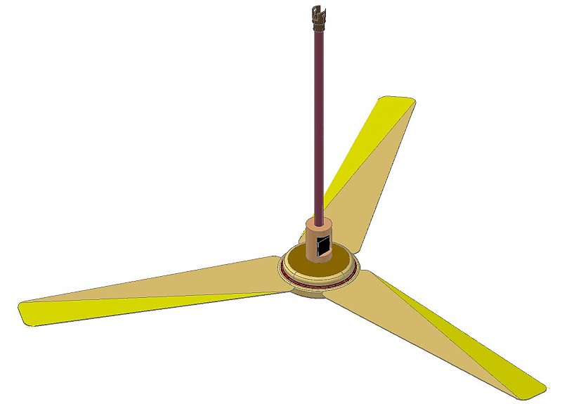

How to continuous rotate the fan as it actual run.
I want to record the fan rotation video as a media file, but i could not do it yet. Pls help me to make it rotate then record in Autocad 2010.
image is below:
i reckon you can apply a continuous orbit to make it appear as rotating - i don't think you can give an object a rotation while filming it - you can make a path for the camera, but not give motion to an object
would like to be corrected but i think i'm right about it
image is below:
This would be trivially easy in Autodesk Inventor. Students can download Inventor for free from http://www.autodesk.com/edcommunity
It must be an AVI file? How about an animated GIF? I posted years ago about creating animated GIF images starting from CAD models. Also I remember others posting Lisp routines about the same subject.
