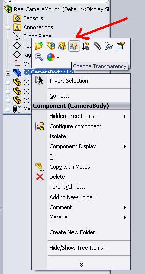

shift1313 Posted November 23, 2009 Posted November 23, 2009 can you change the transparency of the outside of your model. do this by selecting its name in the model tree and clicking the transparant assembly icon with glasses. Quote

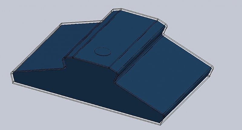

kirayat Posted November 23, 2009 Author Posted November 23, 2009 actually inside my model is totally blank, my simulation only want to test the heat flow inside the zinc roof Quote
shift1313 Posted November 23, 2009 Posted November 23, 2009 in Windows if you right click on the file name, the pop up window should have a "Send To" Then select "Compressed(ziped)folder". This will take the file and just compress it to a smaller file that you can attach here to your post(if its under 250k). Just looking at your model tree id say the problem is you have a multibody assembly thats not "sealed". Are you using Cosmos FlowExpress of FlowWorks? FlowExpress only supports one inlet and one outlet boundary condition. I believe flowWorks can do external flow as well as heat but the basic cosmos express will need to have a fully sealed body in order to do a flow analysis. Quote

shift1313 Posted November 23, 2009 Posted November 23, 2009 no problem. I got the files opened and the problem is the way your roof goes through the sidecovers. Your side coveres are solid and so is the roof. What is the design intent with the part? Basically when working with multiple parts, each has to terminate at a face and be mated. Having parts go through other parts or having gaps is not allowed. If you go to your Tools menu there is something called "Check" in here you can select maximum edge gap and Check the assembly. It will let you know if there are any invalid entities, cabs and so on. im going to play with it a bit and see if i can find any other issues. Quote
