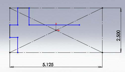

Hi, I'm stuck on dimensions. Everytime I do it, it keep on getting mess up.
Below is a quick paint picture of my troubles that will hopefully better explain.
The overall dimension need to 5.125in but everytime I use "Smart Dimension" the drawing looked like picture "B". Help me please. Why does it lose it shape and get deform like picture "B"

You are in the wrong forum - you should have posted this in the SolidWorks forum. For beginners I recommend sketching one line or one circle or polygon and dimension it immediately. This will give you a sense of scale for the rest of the sketch.
just as jd said, dimension 1 line first. the problem is your drawing is not to scale.
You can start by adding two vertical reference construction lines if it helps you. one at the origin and one 5.125" away.

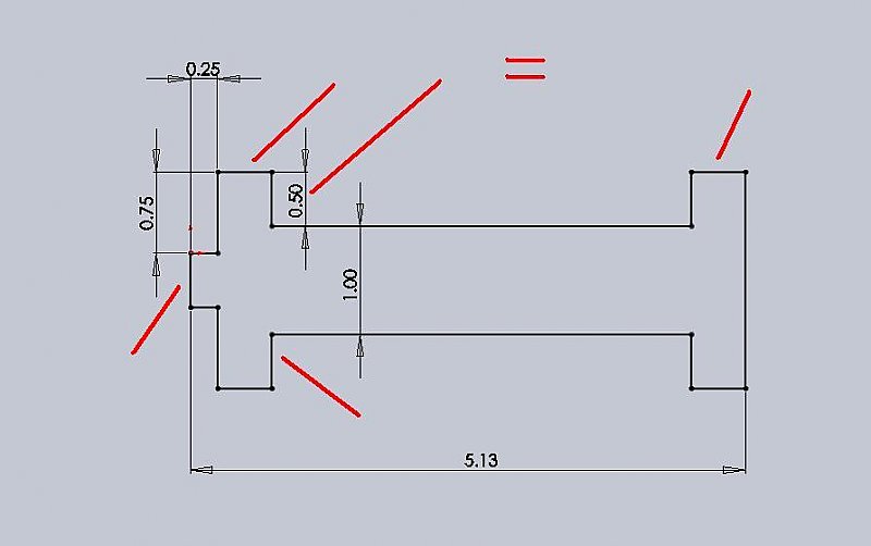

here is an example for you.
I added the minimal amount of dimensions and fully defined the sketch using relations. all the lines im pointing to in red i gave an = relation so they all are driven by that .5" dimension. There is also a number of Colinear relations added to various lines to fully define it. If you draw the short line from the origin and the line to the far right you will have an idea of the size of your sketch. Right now the overall dimension is probably in the 6-7" range and when you add that 5" dimension its pulling your end line in but leaving the rest in place because they are not defined.

Smart Dimension in SW basically lets you select your components and allows a number of different dimensions to be added based on cursor position.
Another technique is to create a construction sketch box the overall width and height of your object and then simply trace over it and add you dimensions. (see attached)
