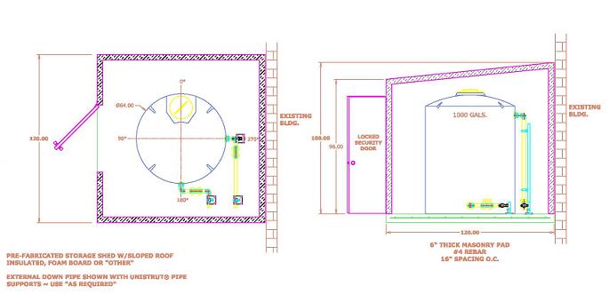

SuperCAD, I just used your block, bit of edit for size. Otherwise, fine.
Well don't just leave me in the dark. What did you edit?
Well, not exactly edit, but I will. I can use the block.
I picked up your door handles. This little job was just showin' a door.
I'm workin' on a little project in PA. Not the big jobs like I did for Jenny-O, SnapOn Tools, and Janesville (all in WI)!
